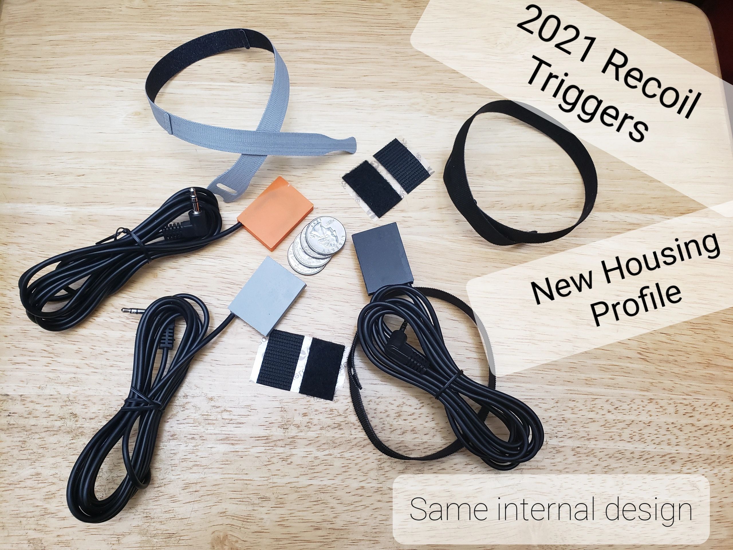

One accessory I would highly recommend is the external trigger. I had issues with the unit missing reads on the internal acoustical trigger. Once I got the external, the unit reads 99% of shots successfully.

Preventing the internal microphone being set off by other shooters is only one of the things the external kinetic trigger will do. There are several additional perhaps not-so-obvious ways it makes the unit more functional and more reliable. These include things such as letting you place the muzzle in a much wider range of locations relative to the unit, i.e. slightly in front, slightly in back, etc. Many of those positions were were not possible with my LabRadar such that the internal microphone would still reliably pick up every shot. With the kinetic trigger, it doesn't matter if the muzzle is a couple inches in front or behind the unit, 6" or one foot off to the side, etc. Obviously, it is desirable to place the muzzle in the same position relative to the unit whenever you use it, but with the external trigger, you have a wider array of positions that will work equally well. I would strongly recommend getting the JKL kinetic trigger and the magnetic mount, they simply make the unit work better and more reliably, IMO. You won't regret the purchase. I made my own magnetic mount before JKL had one commercially available. Their magnetic attachment is simpler, far less expensive than the one I made, and absolutely worth the price.

My next decision will be what kind of triggering device to get. I don’t really want to go with something that requires velcro for a recoil trigger and the magnetic one is questionable as to where it should be fastened. I was thinking of the microphone one, as there will be no one else shooting to give false triggers.

If there's no one else shooting with you, I'd try the internal trigger first. Should that not work for you try the airgun microphone (quick note: someone mentioned there's more to the trigger than just a mic plumbed to the jack, so I never tried a homemade job.) If that doesn't work, you'd need to go with something like a kinetic trigger mentioned above.

The recoil trigger is nice when it's a crowded range with people shooting next to you

I'm probably going to butcher this, but here goes. When the unit is armed it is constantly scanning. Activating via the internal or external mic only writes what it is already seeing to memory. There will be no difference in where it picks up between internal and external. The piet recoil trigger is what I chose for mine. It was well worth the money. The Apache 4800 case from HF holds everything nicely as well.
Well Andy, I guess we think alike. I bought the Piet trigger last week and today I went to Harbor Freight an bought the Apache 4800 also. Actually, just finished putting the unit and accessories in it 2 hours ago.
My bench setup may not be conducive to triggering the unit with the internal trigger. I can’t help but think that by the time the Piet activates the unit via recoil, the bullet might be out of the barrel and headed down range, but I certainly could be mistaken and hope I am
