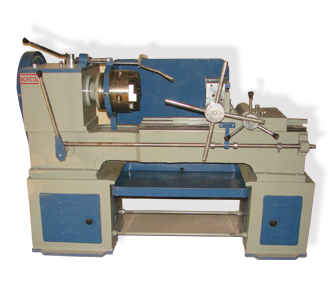

I don't know who "them" is but the old Remington pull off barrels I have were threaded on a threading machine with a large Geometric type head.
You can see where each of the 4 die edges stopped when the head popped open. In the old days I threaded thousands of pipe nipples, bars and bolts on one of these machines.
While machinist on an engine lathe might take 30 min to thread a barrel, threading one on this machine takes about 90 seconds.
