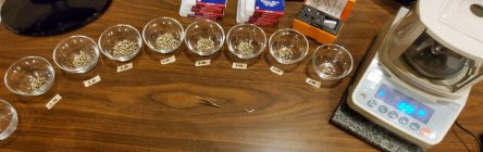

I use a large size 1 week pill box and sort in grams. That gives me 7 "bins" to put the primers in. Once you find the middle weight it's very easy to to just drop the primer into the appropriate weight bin. In the case of BR4's, mine goes 237,238,239,240,241,242,243. No matter the lot it seems that the 240 & 241 bins fill up the fastest. A pill box will hold +/- 1000 primers.

I sort my primers to 0.001 gram because it makes my match ammo more consistent and uniform and reduces fliers, it is a simple task but time consuming.
@quest450
I see you have a few @ .245 and a few @ .235.
About a 4% range. I also return them to the 100 primer sleeves instead of pill bottles :eek:
Have you shot those to see the different in velocity and waterline on target?

I have not, I use those for foulers and a full 100ea sleeve for match rounds I do test a lot of things but that seems like a waste of barrel life to me and maybe I just do not want to find out the results because it could change my reloading process and if it ain't broke I'm not gonna try to fix it
