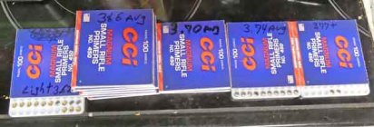

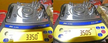

The last brick I sorted came out to 366 grains per flat, 3.66gr average per primer.
I called anything outside +/- 0.04 grains an outlier and suitable for fouling rounds, pew-pew-pew practice rounds, or suitable for conducting a PRIMER TEST.
Here's one brick sorted. 3.67 gr average sorted to 0.04gr bins.
Light and heavy Ginex from one brick
and WIN41. Tare empty flat, weight 100, light and heavy found in same flat.
