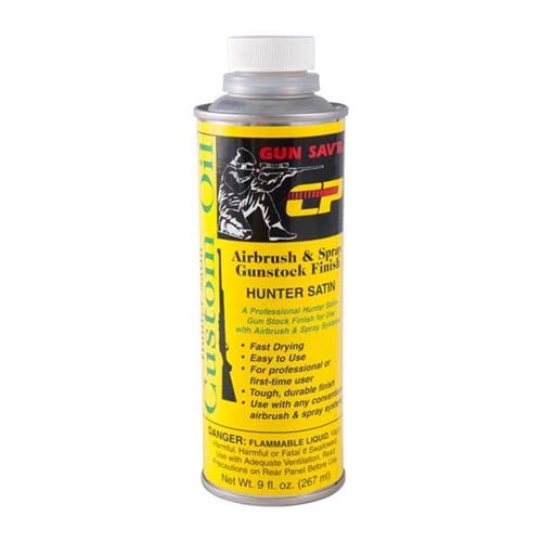

I used this on a Richard's Microfit laminate stock last month- it's satin, not gloss ( I didn't see where you specified what you are looking for). I was really pleased with the results. Takes a lot more time (I think it was 8 coats sprayed in total, wanted the depth) to apply but it's very forgiving.
I’m no professional painter either but have cleared a couple laminated stocks as Aaron described. You just wet sand out imperfections and add coats as needed. It was time consuming but rewarding.
