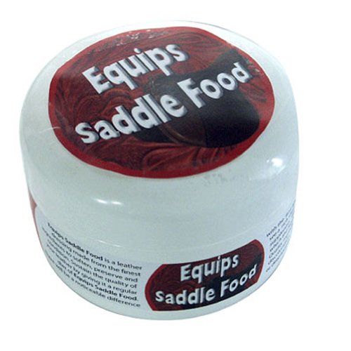

No experience with Holsters, but this stuff is great on everything else.
