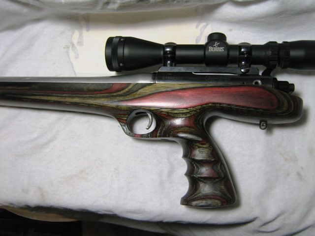

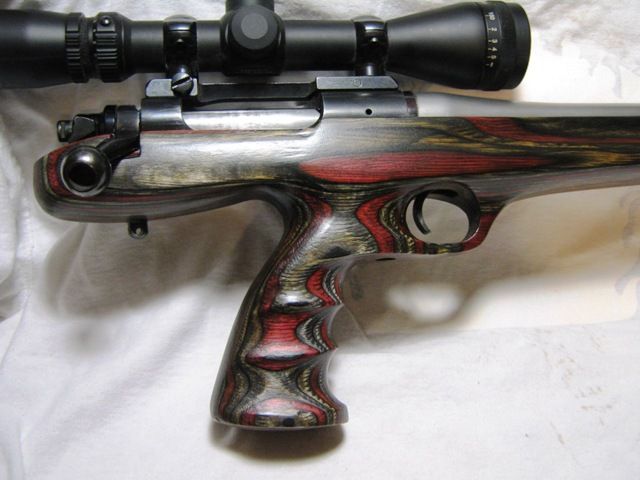

well guys it's done! had to use an old wood trick to get rid of the light spots. steel wool soaked in vinegar for three days, when applied the wood turned weathered barn gray.
Very nice job! If Tikka used that color combo for thier Sporters, they'd sell alot more.
I see the spots you were talking about. Good job on blending it in. Actually gives it a little bit of custom character. Looks great! :)
