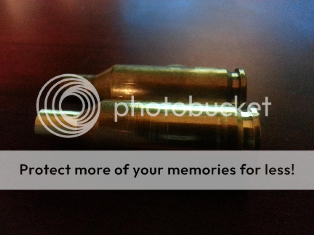

This is an excerpt from a post on this topic a good while ago. I still have that original 6br reamer which is too small at the base for Lapua Brass. Y'all can take from it what you want.
jrm850 said:
The Lapua Brass is almost a full .002" fatter at the base than the fired Norma Brass and will not fit in my old bench gun chamber. In the attached photo the lapua brass is the one in front and you can see the scuff marks where I tried to press it into the chamber. The Norma brass behind it in the pic has been fired many times and still fits. Both have had the necks turned for clearance and trimmed to the same OAL. Remington Brass fits aslo but I don't have a piece to compare with. The Reamer is an Old JGS that just says "6mm BR Match".
