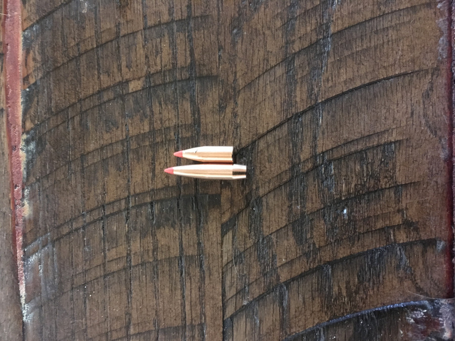

My barrel has a SAAMI spec freebore and the 75gr Amaxes just kiss the lands with the heel angle of the boat tail a hair above the neck shoulder junction. Common misperception that the long nosed VLD type bullets need a longer freebore. That has not generally been my experience. Usually a shorter freebore is required because the bearing surface is often shorter with a VLD type than on a more conventional bullet, even if it is lighter. I can reach the lands easily with both the 75gr Amax and the 55gr Vmax. In fact, the lighter Vmax has more bearing surface than the much heavier Amax.

No dog in this scrap, just curious, but have you bothered to see how close you can get a 40 V-max to the lands?
