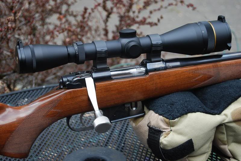

My 527 is a 17Rem from several years back. Sounds like you have the same problem mine had. It wouldn't zero even with the scope completely maxed on elevation....something you don't want to do. The problem wasn't rings or scope but the action. The ring mounting pads of my action aren't level with each other.......the rear flat is considerably lower than the front. My solution was a pair of short little bases that fit the dovetail and are for Weaver style rings. Then Burris Signature Zee rings which I prefer anyway. Works perfectly now and at zero the scope adjustments are centered nicely. Those bases are sold by a company that supplies 22lr stuff, don't remember the name.
I also tried the factory CZ rings that came with my 527 221FB. They worked, but marked the scope tube and did not allow low enough mounting. I was using a Lupy with a 40mm objective.
So I ordered a set of James Calhoon's "Hunker" rings.....MUCH better machine work, better fit and finish, and allowed the scope to mount a full 1/8" lower than Leupold, Burris or the factory CZ rings. This arrangement gives a better looking arrangement, and much better cheek weld.
Just sumthin' to consider. :)
Nice looking rig - at first glance it looks like a Sako - at least how the Sako's looked 25 years ago or so.
I will keep those Calhoon rings in mind, although it does look like you have to use his modified bolt handle to make them work. But I like the bolt handle too.
Thanks for the tip!
That bolt handle and knob came from CRT (CustomReloadingTools.com). It now wears a teardrop knob. CRT has both the bolt handle and various knob configurations available now for the CZ 527's. HTH

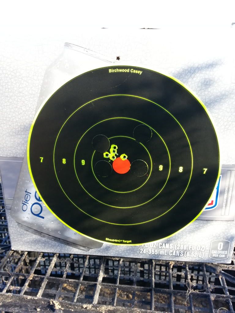

Update on the CZ .17 Hornet
I just got back from the range after receiving and installing the genuine CZ rings on the rifle.
Finally got the scope and rifle playing nice together. First groups were all under an inch at 100 yards. Not bad for a brand new rifle and the first few shots - finally on paper!
Thanks again to everyone for all the input.
