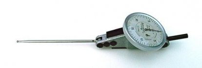

Excuse my ignorance, but how much further? Say a 308 W caliber, how much past the throat the indicator will reach? ( never used one....)

The below Interapid is the defacto standard for high quality long stem indicator. The point is 2.75" long. They also make one with a 5.5" point.
