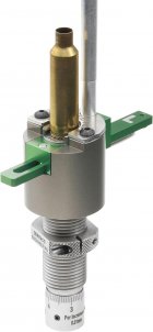

did a check on some different shell holders .they are different
@misser , the usual dimension on a shell holder is the height from the base to the top of the tool and typical ones run at more or less 0.125" What are those number values in your photo?
I measured form where the brass would set to the place the shell holder would hit a die . its IMHO to reuse the same shell holder every time ,I never use a different one as the head space would be set differently
