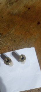

I think I may have gotten it right. I made up 2 rounds with 29 of Varget & jammed them .008. Looked better & brass needed resizing. Then I made them again & brass will go back in chamber with a touch of resistance.
That right there is a headspace problem. Id the casehead is tight againsr the bolt face, primer cant back out. Another of your posts said those cases were jammed .005" when shot in another kbarrel. There's your answer.. Short brass and light load. You don't need to be shooting a lighter load to "break in" a barrel. In fact you don't need to break the barrel in. If it were me, I'd probably anneal the cases, then shoot them full power with bullets jammed.
Sounds good. Thank you. Now I need to find someone who can anneal them for me.
Just go with the universal load of 30gr of Varget, CCI 450’s and a 103-108gr bullet at just touch or even 5-7 thousand jam and let those cases get properly fire formed.
In post #30 the picture of those two cases seem to show that the one on the right has black marks on the case head… Are you still getting gas leakage?
Any of those that have leaked should just be discarded.
