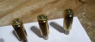

6BR primer problem. Primers are raised somewhat after firing. Just put on a new barrel & breaking in with some low speed loads. Any help would be appreciated. Trying to get pic from my phone.
Seat bullets out to engage grooves, your fireforming I presume, seat bullets and get a good feel on bolt close a tad tight, the primer is coming out and then brass hits boltface I think primer is flowing around FP I could be altogether wrong... I would seat bullets out but just make sure boltface isn't worn from washout also

OK So they grew from 1.158 to 1.164. Too much right?
.006” is a fair amount of stretch, especially for un-annealed “Fired a few Times” brass.
That gives the case plenty of room to have a jump in the chamber before the case expands to fit the chamber and .006” is enough room to have the primers blown backwards allowing the gas leakage and the final expansion to reseat them.

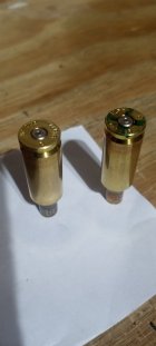

Have you checked the primer pocket now ? How do they look?
The photos show gas leakage up the sides of the pocket and that generally means that you will find erosion groves in the sides of the pocket and that means toss those ones into the scrap brass bucket at the range.

Yes the primer pockets are shot. So should I adjust head space at least .003 or 004?
For sure, I would never run more than .002” bump, especially since you are not annealing the cases and they will be a bit work hardened and resisting stretching to fill the chamber when fired.
It appears that your current loaded ammo is just too short for the chamber and that is allowing the primer to back out under the pressure of ignition and then when the case finally expands enough to fill the chamber the primer is forced back into the case but the damage due to the escaping gas has now ruined the case and is also damaging the face of the bolt and firing pin hole. Losing the brass is one thing but having to have your bolt repaired will be costly…
