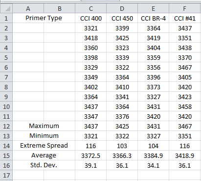

Also for what it may or may not be worth the below images were a result of using CCI 400, CCI 450, CCI BR4 and CCI #41 primers. The load was 26.1 grains of H335 powder below a Sierra 53 grain HP Match #1400 bullet. The cases were all loaded with each charge weighed. The target was at 100 yards using a Remington 700 bolt gun.
Worth noting is the velocity chart in the second image and while the CCI #41 afforded the best group that may not be true as I was close to my sky screen edge when I shot the target so was more concerned with just getting each 10 shot group over the chronograph than trying for group size. Anyway, this is why you really want to see what works best in your rifle with any given powder.
