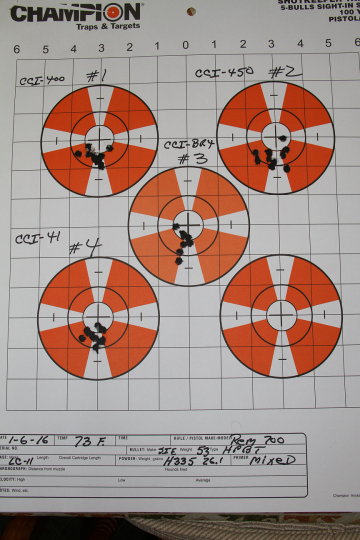

I have been testing the CCI 450 and the CCI BR4 against each other for a couple of years. In the .223 with Varget I can see no difference. One day the 450 wins and the next the BR4 wins. I started using the Mag primer in the .223 back when you couldn't get primers. What I found was there was an immediate improvement in my groups. Who knew? Now I try and keep a 4 year supply of primers just in case.

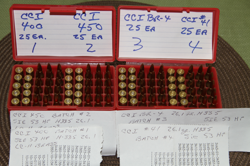

A few years ago I did a little science experiment using all CCI primers in a 223 Remington bolt gun I put together. Each of the four groups were shot at 100 yards and they are 10 shot groups. I was more concerned with getting the groups over the chronograph than holding and squeezing for group size. The brass was all LC 11.
Here are the velocities I ended up with and each powder charge was hand weighed, all the cases were the same sized and trimmed the same. I wanted as much uniformity as I could get in the loads. The best standard deviation was the BR 4 primers but the CCI #41 gave the best group but again I wasn't really focused on group size as much as not shooting my skyscreens.
Finally the target.
