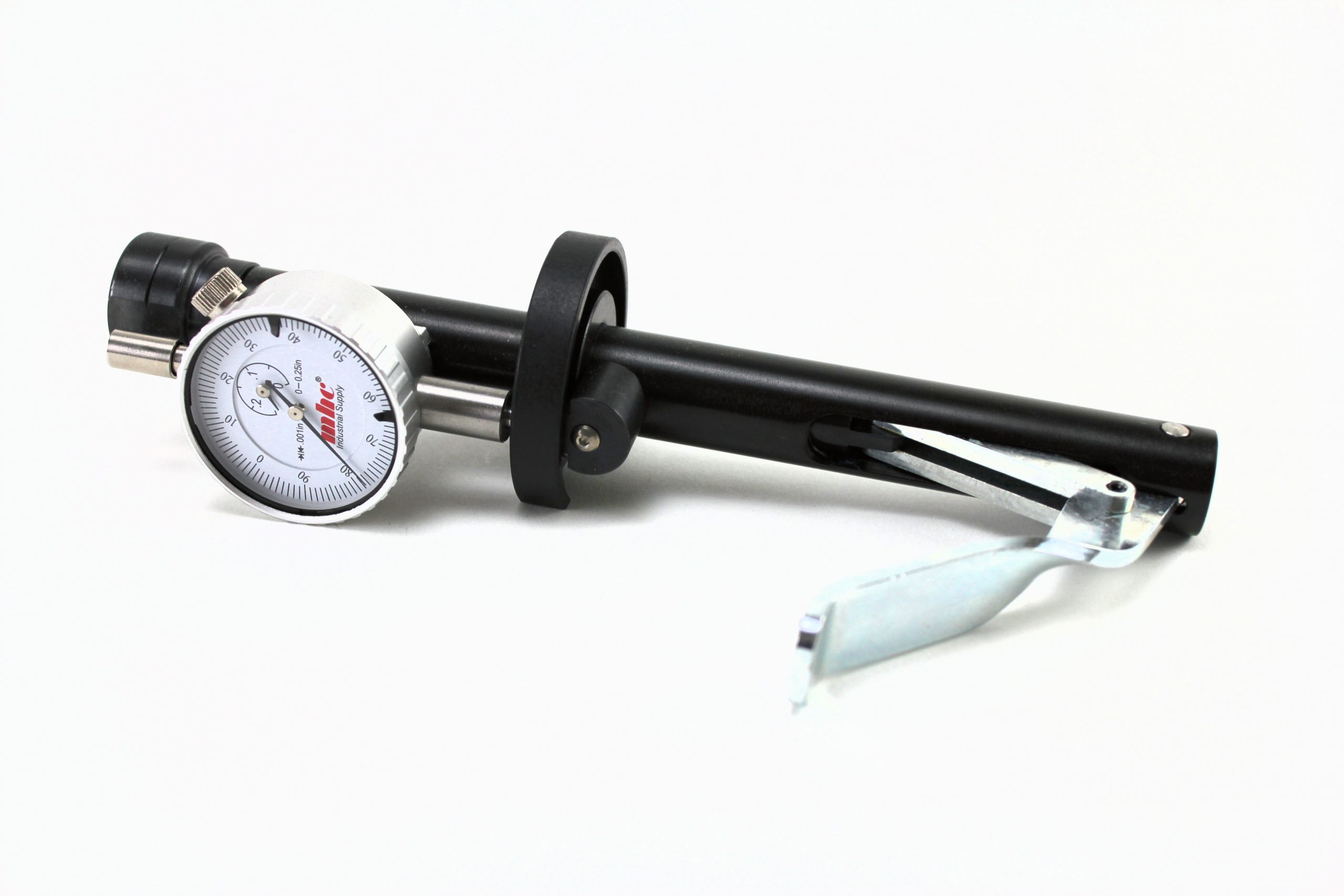

I use k&m uniformers.
Measuring the depth a has primer seated, and even sorting by this seating depths, doesn't do much. Primers should be seated to a consistent crush. Since primer cup heights vary and even uniformed pockets vary, seating to a consistent depth doesn't mean much when it comes to getting a consistent crush.
You can get close by feel with a quality primer seating tool, but the gold standard is to use the K&M Primer gauge. This tool measures the pocket depth of the exact case and the cup height of the exact primer you are about to seat, which allows you to see the exact amount of crush.

The general rule of thumb is .002" crush for a small rifle primer and .003" for a large rifle primer. Of course, that can be adjusted anywhere up to about .005" for fine tuning.

I am saying that measuring primer seating depth isn't the right measurement. Primer crush is the right measurement, and there is little correlation between primer crush and primer seating depth. We may think that we have achieved consistency in primer seating when measuring seated primer depth, but we haven't. Uniformed primer pockets have variation, and primer cup heights have even more variation.
I used to seat the primers for my 1000 yd BR rifle by feel, measure the seating depths, try to fix the shallow ones, and then sort them into groups based on the measured seating depth. This was with primers that were weight sorted. The ES of my best loads was in the mid teens with my 6 BRAI.
Then I started using a K&M Primer Gauge. This tool measures the depth of the pocket and the height of the primer cup of the exact primer and case being seated. The ES of my best loads dropped to the high single digits.
Now I don't obsess about ES, I obsess about group size. However, ES is an indicator of the quality and consistency of our loading practices. While primer seating isn't all of the equation, I did shoot four IBS 1000 yd screamer groups this year, one with my 6 BRA light gun and three with my 300 WSM heavy gun.
None of this level of primer precision is not needed outside of LR BR and maybe ELR. For most disciplines, simply seating the primer until you feel it bottom out and then squeezing it a bit more works extremely well. And if you have a good enough tool and feel, this method works well in LR BR as well.

The total variance in cup depth and primer pockets can be as much as .005." Most if that is variation in cup heights. If all your seated primers measured .003", and there is .005" difference in primer cups and pockets, then the crush is nowhere near being consistent.
I too have the Accuarcy One tool, as well as another custom made primer tool. The only way to get a consistent crush using these tools is to sort all the cases by pocket depth and then measure all the primer cup heights. I no longer use these tools.
This tool fixes all of those issues. It is slower than a typical primer tool, but since you don't have to measure anything after you are finished the total time spent priming is less.
