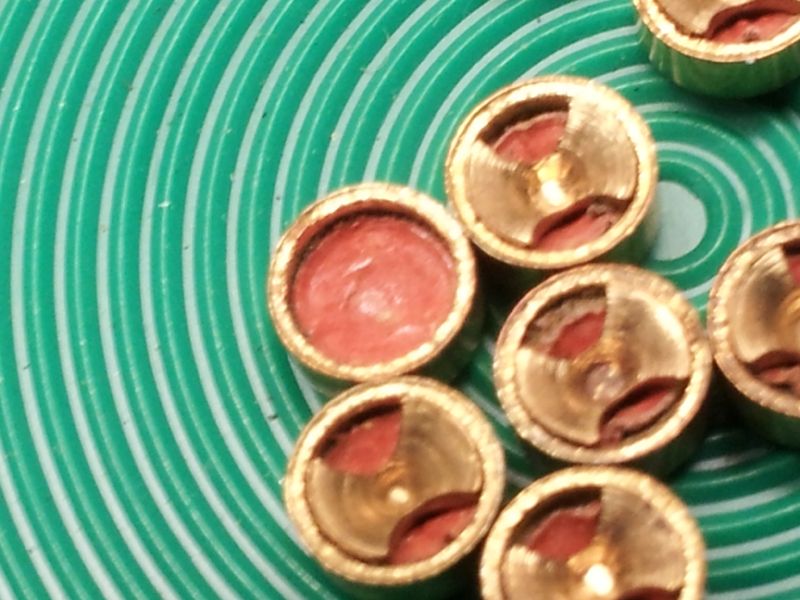

The foil is there, Cat, but it is embedded in the compound and is not normally noticed. I loaded for four years before I saw a couple that had become separated.
Nonsense... if you knew how primers are made, you would know that is impossible. Four whole years - golly, I am impressed.
What is it that you find to be impossible? That the primer does in FACT contain a piece of paper foil, or that it can't become separated? Not possible :o Oh my ::) You'll never admit you are wrong, will you Professor ;D
Reference the photo on thread #39. I suppose my eyesight could be failing me, but, it appears to me, the compound shows separation ???

Lesse....
First there is a felt pad between the pellet and the anvil. But that would cushion the firing pin (and be easy to see), so that is not working out.
Then the felt pad is inside the pellet to absorb moisture - but felt is hydroscopic, so that is not working out... and how did the felt pad get "inside" the pellet??
Then the foil is on the pellet, which also should be easy to see, but it is not there... so that isn't working out
Now the foil is inside the pellet??? Are you kidding? The pellet is extruded wet into the cup, so how did the foil get inside of the pellet, and the greater question is, why would a primer manufacturer put a foil inside the pellet - and to what end??
"I suppose my eyesight could be failing me, but, it appears to me, the compound shows separation.
Get some eye glasses, your eyesight is definately failing. There is no compound separation.
No felt, and no foil... just priming compond that shows the impression of the anvil when it was put in while the pellet was wet.
Now, grow up... you don't know doodley squat about this.

Photo on post #39. No? Your cop-out is quite sad Professor ;D The photo you attached is most certainly NOT the photo on post #39. That particular photo CLEARLY shows the separation in the priming compound. I'll help you out. #39 is the post before #40, and after #38. And then we have the statement from the FBI forensic lab, dated 2011. And you maintain experienced, professional knowledge, regarding the manufacture of primers ::) Your credibility is shot ;D Stick to the ivory keys on your piano, and walk away from the keyboard on you computer ;D ;D ;D Maybe…. just maybe…. you might use your Rockwell hardness tester to ascertain the existence of the paper foil ::) I hope you aren't looking for something that resembles aluminum foil? I can only imagine, the different primer makers don't all use the same colored paper foil :-\
You are wasting everyone's time with this - that photo shows nothing that relates to your fantasy, and name calling does not enhance your case... you lose.

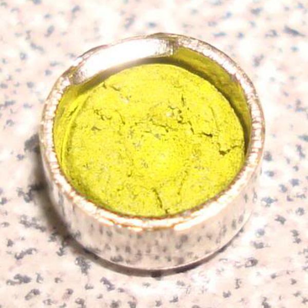

So you really don't see the separation in the compound :o When the very thin film of paper foil drys out over time, it separates. No??? What happens to your skin when it dry's out Professor? Unfortunately, we don't want to moisturize the primers to mitigate the cracking and separation. They probably wouldn't ignite too well ;D
BTW: I have not "called you names" and don't intend to ;) On another note: i've lost (as in lose) many times, but, i'm not "loose" ;D
Nothing is separating... paste that dries commonly shows surface cracks, like dried mud.

Here is the response from Federal Premium Ammunition:
"The colored material visible under the anvil of a primer is not the priming compound itself but rather a sealer used to keep the pellet in place during manufacturing and transportation. Paper/foil disc or lacquer type sealer in varying colors or clear are used".
