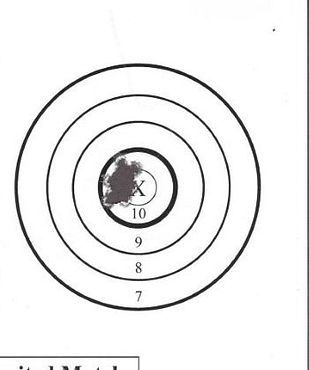

Here is an example 50 shots 100yds. Lapua CX first time shot in this rifle at 100yds.

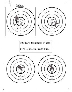

Three different lots of Midas in three different rifles. The fourth, bottom right, is CX.
The trouble is that at 100 yards the ammo doesn't give these kinds of results consistently. Whatever the rifle and lot, it can be challenging to shoot many consecutive sub-1" ten shot groups at 100 yards.

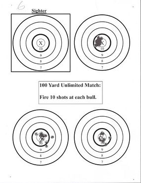

The other groups on the same targets.
