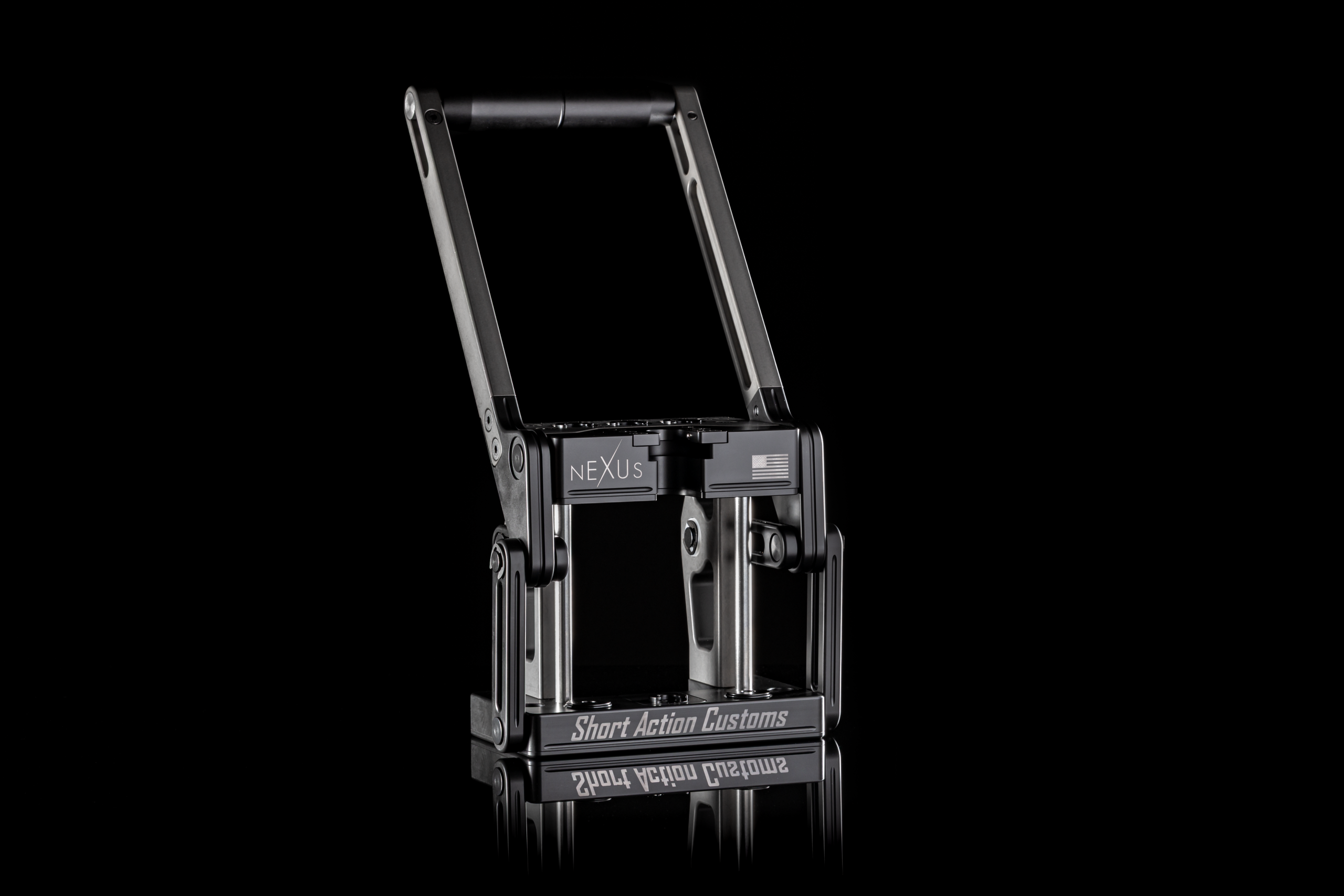

I had one and used it for a while. It is built like a tank and the material used and machining is top notch. It will size anything with ease. I had the 120 . I didn't see where it made any better ammo than the top RCBS and Redding presses I have but it was a lot smoother and really nice to use. If you have the resources and the appreciation for a fine press buy it. I wish I would have kept mine
Do you have one? If so, what has it done for you?
No I do not. Maybe I should not have answered but you asked about group size. No press can do anything to decrease your groups. The purpose of the press is merely to insert the case in the die. Think of Wilson dies for example. Or any other die. That’s where the actual forming of the case takes place. How it’s inserted in the die is really of no
importance.
Now I own eleven presses. 7 are mounted.
Why so many? I like tools. I also appreciate properly designed presses. Example would be MEC. Beautiful. However the designer never went to engineering school. The method used to mount the handle is the worst and weakest imaginable. Therefore I don’t own one. Do any of my presses have anything to do with group size or accuracy? Nope. Not one bit. Are some more user friendly to me? Yes. There’s hundred or thousands of things that attribute towards accuracy. The press is not one of them.
I agree with you. Custom dies do that job. I DO like different presses, and have a few. A couple Hollywood Seniors, a little blue RFD, Lee Classic Cast, Rockchucker. But lately I picked up and fancy one from a friend....The 419 Zero Press....That thing is spoiling me. I even figured out how to use my arbor dies on it. Good equipment makes the process all the more enjoyable.....If the Prazi is going to scratch that itch....I say...... Scratch Away.

Odd that the Co-Ax does not get a mention, the shell holder/spring jaw setup allows for the case to directly align with the die and helps ensure that there is no misalignment between the the die and the case being held in the press platen.
That alone is the selling feature of the press and can contribute to the concentricity of the case and bullet as the original question was about “Run Out”.
My Bonanza {the original Co-Ax before Foster bought it} loads ammo so close to perfect that I no longer bother to check case to bullet alignment and have never seen any difference on target between the 1/2 thousandth runout to the 3 thousandth ammo…
Sure. But there is enough slop ’ in the shell holder to allow alignment. If there wasn’t it be a real fight to get the case in the shell holder. But then an easy solution I use all the time. An ‘O’ ring between the die and the press.
I'm just looking for likes and dislikes and what it has done for owners of this press. BUT
M-61 you say a press means nothing to your loaded ammo so tell me then why do you put an "O" ring under your die. Now I use a Lyman Orange Crusher, bought in the early 90's and hand dies and arbor press and I don't have to use any "O" rings. I do check and have the same runout as the Prazi. My bump is not always as close but its not far off and I have won my fair share of wood over the years. I'm just trying to find out the pro's and con's of this press as I do enjoy a fine piece of equipment that works extremely well.
If you want one of these premium presses . By all means buy it . You only live once. Nothing wrong with wanting nice tools. That being said . If the goal is just to shoot the smallest groups. Look at what those winning by shooting the smallest groups are using. Reminded me of this post .
