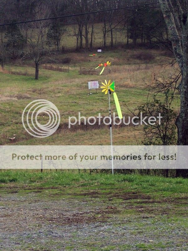

just got flags and trying to get a grip on how much each change will actually move a 105 VLD at 300 yards from a 6BR,,shot these 3 groups today in what seemed like not to bad wind until I put flags out and the head wind would change from 10 to 2 oclock and back sometimes every 2-3 seconds,,
shot group in middle first and first 3 shots are in one hole to right,,my first flag at 15 and second at 70 picked up on 4th shot and the 3rd flag at 150 cranked up on the 5th as in the first flag picture,
second group shot is on the right and had a head wind that was switching to the left and speed up and slow down then the last group on left shots were alternating back and forth between the two spots,,

You will learn a lot shooting over wind flags, especially working up a load you will know each shot was fired in the same condition.
When you aint shooting study em in your yard. Take one flag at a time when youre shooting and wait for a change then shoot with the same aiming point. Lesson is to learn what each flag does. Each Distance does something totally different- you gotta figure out the magnitude of each. Putting them out in your yard to watch gives you a lesson on the time it takes for conditions to hold and lets you recognize the prevailing condition.
thats kinda what I was doing today Dusty,,I didnt really wait for a switch but just shot a slow pace maybe 7-8 minutes per group and walked out and adjusted poles up and down between groups,,also adjusted scope between groups to get impact in white where I can see bullet holes easier ,,
after I got done I marked the poles 1-4 and marked the poles height adjustment with a majic marker and marked the ground so it wont take but a minute to put them up and adjusted to see through the scope and shoot,,,,
Nice! Any info on that tall pole on the first flag?
I've got a few that I purchased from a BR guy a while ago... four heads, two tripod bases. I need to get something taller for the other two due to how our range is laid out. That and I need to start *using* them more...
Your poles really need to be as rigid as possible and they need to be vertical. If they are leaned over the flaq will bias in that direction causing confusion.
I let one of our smallbore competitors use one of my rifles in one of our RF BR matches. After sitting there all morning long watching the flags and shooting a good rifle her comment about the smallbore comps was "We have NO IDEA what the wind is really doing".

My experience is limited to short-range BR 100-300 yds. Ditto on the importance of having the poles true vertical. Not hard to make a small bubble level on delrin rod that mimics the pivot in design. That first flag was definitely lying to you.
