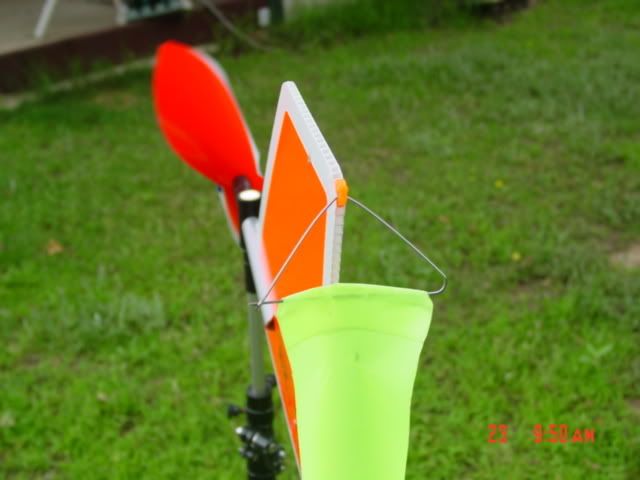

I am looking to design and build my own wind flags. Does anyone have a good suggestion for "frictionless" pivot bearings for a Wick style wind flag? I am looking at different props like daiseys and model plane props. I want to build the flag on a tripod base and using old carbon arrow shafts.
I hope that you have looked and studied flags for a while before building them. I'm one of those equip. whores. I've owned about 15 different BR receivers, barrels by everybody, presses, powder, bullets, and several sets of windflags. I haven't had a bad set, but saw the fallacies of some. I started with Geraci flags, home made flags, Hood flags, Pumpkin flags, and my present BRT Australian flags. All of them will tell you something. I want a flag that is telling me what is happening right now, not what was happening a second ago. Daisys are good in a light wind, but are like a flywheel. Slow to respond to a pickup and slow the stop when you lose the wind. I like tricolor pinwheels. They respond instantly to the wind and changes of velocity. I like the corroplast vanes as they can be big and real light weight. I like my sail cloth tails shaped like an old venetian blind. They don't flop around in the wind. They just rise and fall and keep a stiff shape.

IME, bearings sound like a good idea on the surface but actually slow flags down, as opposed to a well designed flag. Opposing magnets are great but most of the friction comes from side load. FWIW.--Mike Ezell

Yes, probably so Butch and yes, I am speaking specifically about opposing magnets at the pivot point. Problem with opposing magnets is that particularly with a daisy type of flag, they offer very little side load reduction. Because of the area of a pinwheel or daisy, drag increases as wind speed increases. So, what happens is, the static balance point means little because the dynamic balance point is always moving with wind speed(drag). What some people do to offset this is to just make the vane bigger. This just adds weight which much be offset at the front, which again, just adds more weight. Bottom line, most people are money ahead to buy a well designed flag that takes all of this into consideration.

I have studied them for a few years. I shoot heads up most of the time so I look at other people's flags more than what I have. I have a style I like but the nitty gritty of the bearings and materials is the part that stymies me. I have a whole box of chloroplast but the pivot point that rests on the tripod is what eludes me at the moment.
The Aussie flags have bearings in the pivot and a pin is Loctited into the bearing. The pin sticks down and fits into a piece of aluminum that screws on the light stand and has has a female .250 hole in the other end.
