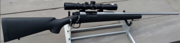

In my 22PPC hunting rifle with 53grn V-Max bullets and Norma 22 ppc brass.
My standard load is: 28.8 Grains of IMR 8208XBR
