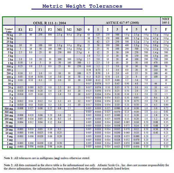

You would be better served by BUYING a 1,2,2,5,10 - - set of appropriate accuracy, and take very good care of them. They will not be cheap, and they don't come from China. If stored properly, handled gently, and used infrequently they will last the careful user for years.
Google weight tolerance charts.

I'll post this just for reference.
Weight class tolerances.
