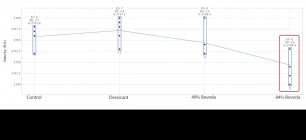

This was a really great experiment done by the guy over at Chronoplotter with great controls to show the effect of humidity.
This was a really great experiment done with great controls to show the effect of humidity.
That’s a very interesting article and test. If someone wants to experiment, they can adjust burn rates. If you’d like to try something between 2 powders, eg; 4350 and 4831, you can add or subtract moisture to adjust burn rate.

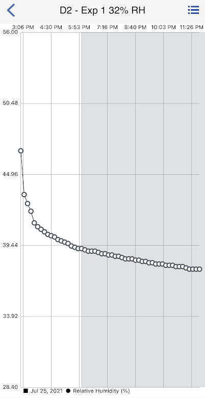

There are places where longterm storage in unconditioned spaces can have a very long term effect. One such case is Las Vegas.
View attachment 1608370View attachment 1608370View attachment 1608370
If stored in this environment in a non hermetically sealed container the powder would ultimately acclimate to equilibrium at approximately 31% but the process would take years in an unopened container.
