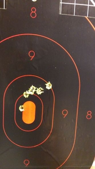

H-4831 is awesome. Here is a pic of a small 7 shot Ladder I did at 330yards. - 72, - 72.5, - 73, - 73.5, - 74, - 74.5 & 75gr. H-4831, 178 A-max, 210M, FGMM brass.
