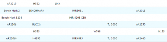

Here is a snip from the ADI chart:
http://www.adiworldclass.com.au/powder-equivalents/
Burn rate charts are only superficially usable. The positioning changes with every change in lot number from the same suppliers. You can't position similar powders next to each other so they get listed as either being faster or slower depending on who is assembling the chart.
Look at the ADI chart carefully, ADI considers it to be a stand alone powder. You're going to have to test.
I'd go further and say that you're being far too kind. Chart position is frequently not even superficially usable Seriously though, there are so many pitfalls in these charts, they're of little use other than making a very general classification. Powder manufacturers appear to carry out, or more likely interpret the results of, closed-bomb tests very differently. Vihtavuori is a serial culprit for listing powders as being slower burning than they are in most applications, sometimes almost dangerously so; Explosia (maker of Lovex / Shooters World propellants) also, but in reverse - ie showing powders as being much faster burning than they turn out, at least for the S-series extruded grades.
