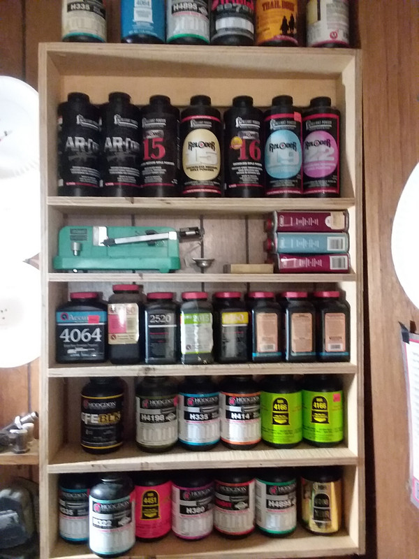

It’s supposed to be in a wood cabinet so it doesn’t build up to much pressure and turn into a bomb if it ignites. I need to update info from my ins company and state fire Marshall. What I’d really like to do is keep it in a cabinet outside my shop but I’d have to keep it temp controlled.
Here is picture of mine made out of wood and lined with concrete.
