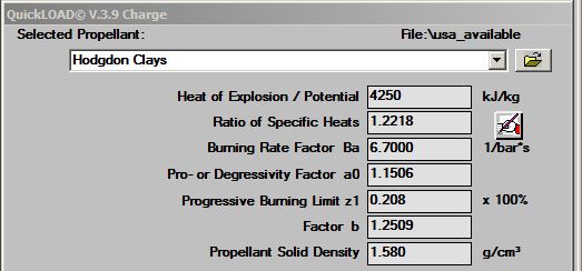

I pared down my QuickLoad powder database 2 years ago after my most recent update, building a 2nd that only showed powders available in the US. This saved me having to edit out unavailable powders every time I imported the Propellant Table search results into an Excel spreadsheet.
I wanted to compare QL burn rates to what is available online. I built a spreadsheet that I could sort parameters from from ascending or descending. Then came a Hodgdon-style colored burn rate chart based solely on QL default numbers for powders available in the states.
Yes, I am so used to referring to it as "Ba" but Ba is the burn rate.

What is the Ba #?? Units?
