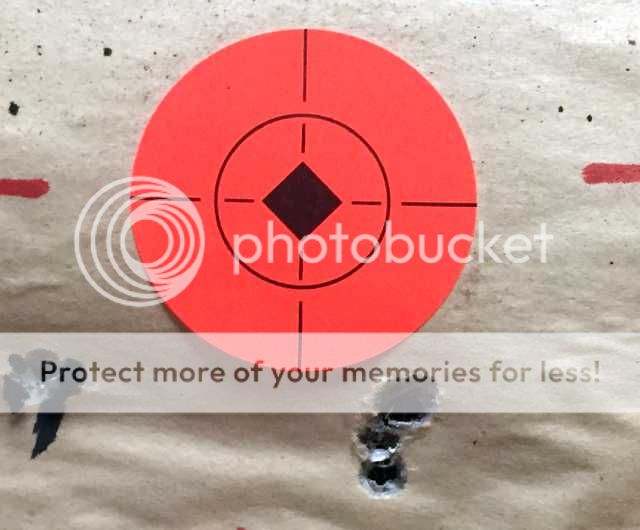

Measure center to center. There is an inexpensive program (try for free) that will measure them on your computer. https://ontargetshooting.com/
You need a reference measurement on the picture of the target. The target dot diameter will work. I put a quarter on this for an exact measurement.

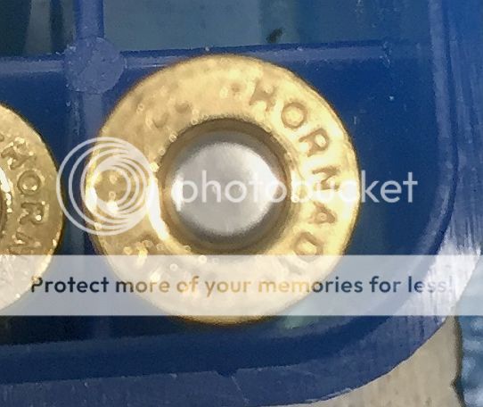

I just took a look at my primers for pressure signs and I believe I'm OK but I thought I'd post a pic of the ones I just shot with the 4064 and one live round to compare. My only question is the little crater just starting on the primers. These are CCI primers in once fired brass.
Sorry for the blurred pic

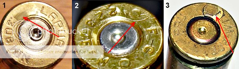

I never could tell much from primers. Some flatten easier like Federals. Having a crater/ridge (1) around them is a definite pressure sign. Here is what I look for, just my personal opinion. Always better to be safe and never run a maximum listed load unless you are sure of yourself and you've worked up to it in tiny steps. I had a load that was 9/10 under the maximum listed load on Hodgdon's website and got a surprise. About a 30% increase in recoil, and the case looked like (3). It had expanded to the point where the primer would fall out. I was working up in 1/2 grain steps. 45.9g was the max, I got the bad overpressure at 45.0g and later I noticed the loads at 44.5g also had ejector marks similar to (2).
(1) On an AR you can get swipe marks. This also has a cratered primer, way too hot a load. (2) this is the case being pushed into the ejector very lightly, a reason to back your load down. (3) Bad overpressure and dangerous. I have no idea if any of these were fired with the primers shown in them when they overpressured. Usually, the primer would be flattened out like (1).
I've loaded up 1000's of .223 rounds and so far never seen any signs of over pressure or anything like the ones you posted.

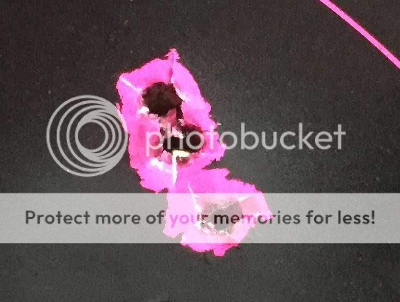

The middle hole is a pair and the top hole is a pair. You can tell because there are no petals in the bullet hole. When the second bullet passed it took the remaining petals with it.
