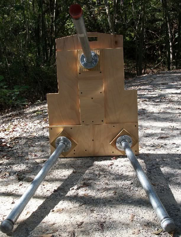

Or you could build your own. All parts are available at Lowe's and/or Home Depot. This bench was used to nail four groundhogs over 700 yards last summer.

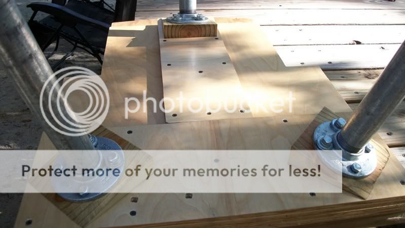

I built one like Nomad's - doubled up 3/4" MDF, cover edges with hard wood, add angle blocks and pipe flanges. The hardest part of the whole thing is making the angle blocks and this is not bad but involved hand work ( at least my 10in table saw couldn't make the entire cut). Low cost, effective, and you get to play with power tools!
A friend cut the wedges for me. I have a limited amount of power tools - living in a motorhome. Another friend, for his bench, used plastic wedges that I think are for splitting wood.
Yeah, cheap. For mine, one 2'x4'x3/4" piece of plywood, the wedges, three pipe flanges, three pipes threaded on both ends, three pipe caps, some glue, drywall screwes, and lag screws.
