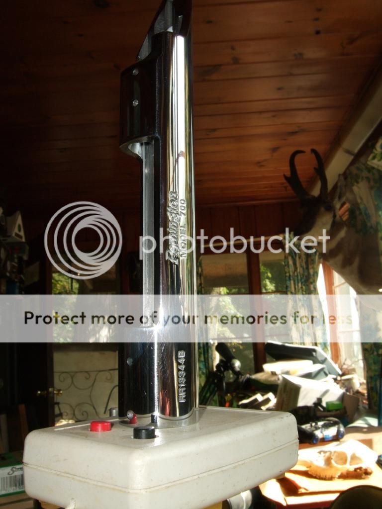

If you have the correct stuff it's not hard to do, just takes time.
This LA 700 was $50.00.....

Turned out easy to do. Sand lightly with 400,600,1200 sandpaper then 20 minutes with a polish wheel on a dremel tool and some mothers mag polish. Stainless action, ptg aluminum bottom metal (comes in really bad shape) and aluminum stiller rail done in 2 hours.
