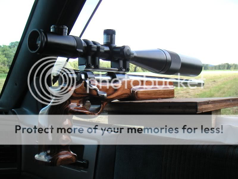

Have a brake installed on your 6br and use a rifle scope on it that provides a generous eye relief. I have a Leupold 8.5-25 LRT scope on my 6br XP. A Nightforce or Sightron makes nice stuff too.

All my long range pistols have rifle scopes on them..

Ihave also used the 3-12x Burris on some of my longer range SP's and loved it. I never did like the eye relief being so long at 12x though. For me it's difficult to use from prone off a bipod with a center grip handgun at 12x. It's fine with a rear grip though. Most of my SP's now wear rifle scopes.

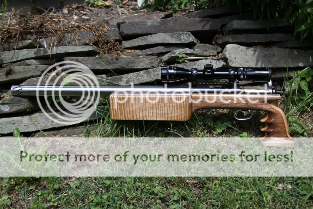

Two years ago I bought my first XP-100 and it is in 243AI with a 12 twist. It had a Burris pistol scope and the boys from Specialty pistol convinced me to use a rifle scope. I put a 6.5-20 Leupold on it and never looked back. The eye relief is really critical on a pistol scope and the rifle scope is actually easier to use in my opinion, even if you are only looking through a partial field of view it does not black out. My pistol has a muzzle break and it is my second most accurate weapon, but just by a fraction of a moa! I have taken 1 boar, 1 coyote and dozens of rabbits shot in the head for the pot. 85 grain bullets are about as big as my gun likes but that is what I use in my 6mm rifles for deer and antelope anyway. Tom
