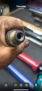

Had this come into the shop today. Spun the barrel off. Guess he figured pipe sealant is as good as threads. IMG_6118.jpeg
Wasn’t that shocked as I have seen this guys work before. This is the type of work he does. I feel sorry for the customer.
Gonna go out on a limb and say this...... person has decided pipe dope is just enough to prevent the barrel from vibrating loose.

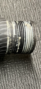

this was not a factory Remington.
Some one actually cut these threads along with a few chicken cuts. Here is a pic the crown. The gu who did this. I have taken apart a lot of his guns. Great for business For me.
