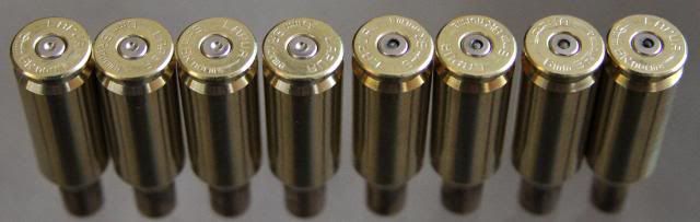

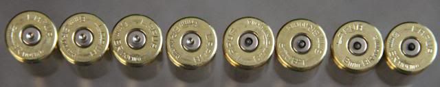

So far I have 100 rounds through my Savage 12F 6 Norma BR 1-8 twist with 30" barrel. After fire forming some Lapua brass, I started to work up some loads. So what I have is once fired Lapua brass, CCI BR4, Varget, Berger 108 BT. My starting load was at 29.6gr to 31.7gr of Varget and the bullets were seated on the lands and had 0.0015 of neck tension. I made three loads of 29.6, 29.9, 30.2, 30.5, 30.8, 31.1, 31.4 and 31.7. Here are some pics of my cases after firing... the left most case is 29.6 and right most case is 31.7.

If you look at the Side view, you can see the primer sort of lifted on the 2nd - 4th case. Also the only time I had a hard bolt lift was on the 31.7 case. I have read that this might be caused by the firing pin and not so much by pressure....
29.9gr and 30.5gr gave me my tightest group... in between those two were not bad at all. By the way... temp was around 65F.

Check your FP with a decent magnifying glass or loupe to determine if it's been eroded by gas cutting. Once primers have been pierced it's often the case a pin has been damaged, likely to result in further issues.

the view of the primers side on, is it the primer has moved or is it actually the cratering of the primer you can see - sometimes before primers pierce you will get primers within the same load or the loads leading up to the piercing will have a severe "crater".
If it is severe cratering then even these loads are possibly too hot...Bushing the bolt face will definitely help the cratering as well. Something I have found that will produce the same symptoms (I think it is talked about on this site somewhere as well) even though the load has been fine - loading the rounds and leaving them to sit for some time (week or more), I think it is something to do with a bond forming between the case and projectile (?).

Yes, I assume you are looking for the most accurate load. It may not be the maximum possible load. You really have defined your maximum load already with the existing bolt. As 6BRinNZ, asked has the primer in the 2, 3, 4 loads actually popped out of the case or is that the crater we see from the side. If that is a crater that is major, and not acceptable in my view. If the whole primer is popping, then I wonder about headspace being a little high. That is quite easy to correct if not right.
That is not the primer backing out. It is the crater that is showing. If you run your finger tip over the base of the case, you will feel the sharp edge of the crater.
