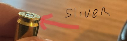

So I have been using lapua in my dasher for a few years now, recently I bought 50 pieces of Peterson brass to try, I went to the range today with 20 rounds to see how it shoots, my load is 31.5 Varget cci450’s 95smk.
now to the issue when I first pulled the trigger everything was fine until I went to eject the case, it came out fine but stayed in the bolt. I pulled the bolt and noticed the ejector was flush with the bolt face, stuck. I took a loaded round and pushed down on the ejector and it popped up, ok I thought must be a one off thing, fired again and same thing I looked closely at the ejector and noticed a sliver of brass lodged between the bolt face and ejector. I looked at the case heads and noticed they were marked by the ejector and had a sliver of brass sticking up, I had some lapua with me with the same load, I fired a couple of those and they are perfect no issues, when I fired the Peterson they fired perfectly no heavy bolt lift primers look great.
so is Peterson brass softer than lapua? I don’t believe my charge is an issue as 31.5 varget with 95 SMK is a mild load.
any ideas?

Although I personally have not tried the Peterson brass, a friend is using it. Like the Alpha brass I have, we both have had to reduce (from our Lapua brass charge) our powder charge a bit due to the smaller case capacity of the newer
brass.

I saw excessive raised primer cratering with my Rem. 700 - 6BRX using Peterson brass as well. Backing off the load a little solved the issue.
Per QuickLoad it is valuable to check case volume because lower volume leads to higher pressure for a given load of powder. I recently checked the volume of some new Petersen 7 Br cases as compared to my Lapua 7 Br cases and sure enough there was enough difference to potentially cause problems.

Had the same issue with 6.5 creed and Peterson brass. I was using a load that was highly recommended by many shooters. After one firing the primer pockets would not hold a primer. Called Peterson and was told the load was too hot for their brass.
My sole experience is with Peterson 260 Rem large primer cases. They're an excellent product, but are heavy and do have less internal volume than Lapua equivalents increasing pressures, but even more so against R-P. Loads need to be reworked on swapping to this make - but frankly that should be done with a maximum load on changing between any makes of brass. Cases hold 53.9gn water (Peterson); 54.6gn (Lapua); 55.6gn R-P after fireforming in my rifle.

I had similar problems with extraction using 6 Dasher Peterson brass even with reducing powder charges.
Ditto on the first offering of the Alpha brass.
Alpha came out with the OCD brass. I think they changed the metallurgy to make it more like Lapua. The Alpha OCD brass I am playing with now seems to perform more like Lapua, and I am not having extraction issues with the OCD brass
