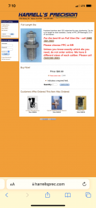

Thanks guys, before I head down the neck turning path, what will the harrels die do to help? @SPJ & @moondog
will it size the body below shoulder more or less?
The reason I ask is I just received a Forster FL die and it sizes the body below the should smaller than the Redding Type S die.

They are bushing dies , so you can tune your neck tension to what the rifle wants.
Ahhhh so they can use the Redding bushings?
Harrells dies pretty much same as Redding and use either Redding or Wilson bushings. Is your chamber a Norma chamber or 6BR Remington chamber? 27 gr of Varget is max for 6BR Rem in the Berger book. Also the velocity for that max load with a 105gr bullet as stated in the Berger book is 2656 out of a 24 inch barrel.
