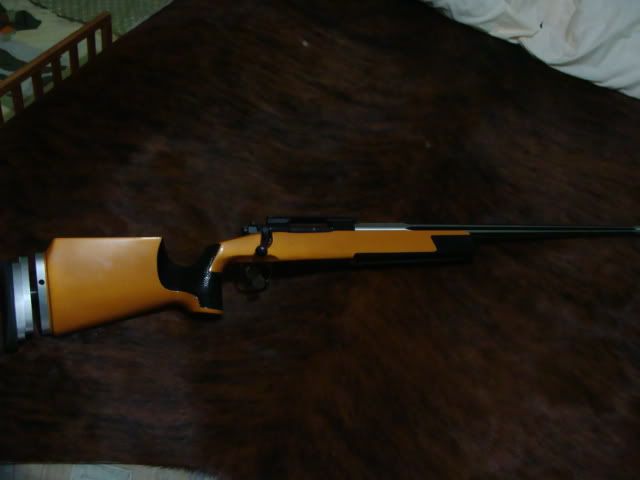

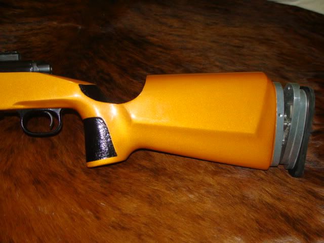

Yep. Here is a Mc Millian Prone stock that is my back up Palma Rifle. Some day Im going to change the adjustable cheek piece hardware to the one that Steve and Shirley McGee sell.
