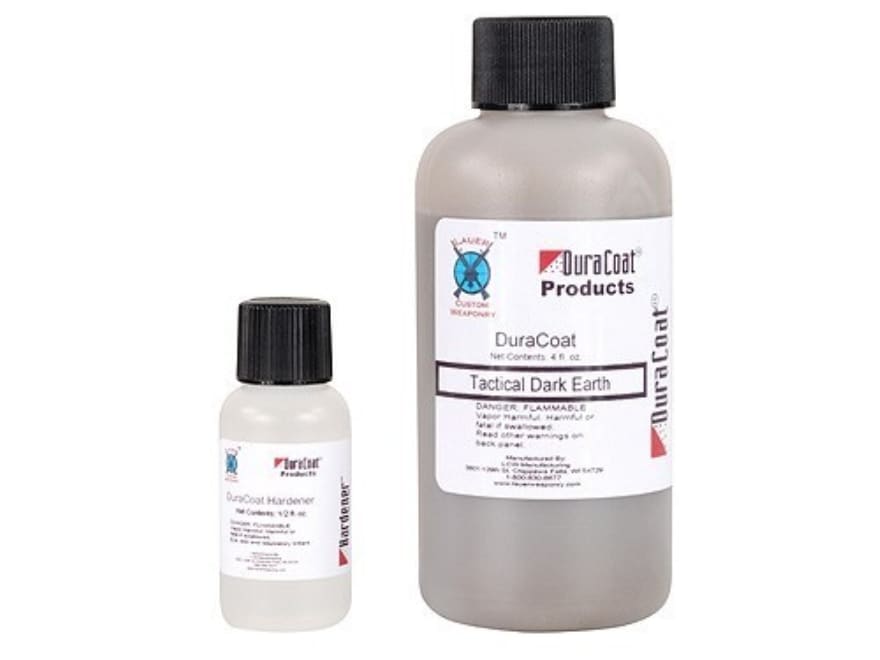

As mentioned prior. Look into Duracoat. It’s also made close to you in Chippewa Falls.
Duracoat gets a bad rap, I think because it has always been sold as a DIY product. As others have said, prep is the key. Cerakote is good but done properly, IME Duracoat is just as good. Parkerizing first, makes the best base for duracoat. It's a good product like that. I've done them for the 3 gun guys who toss the guns into steel bbls and onto asphalt or gravel when changing guns and the stuff holds up to that. I don't think you can ask for much better. I've also seen it perform poorly due to improper prep. My 2 cents, sandblast, parkerize, degrease thoroughly and rock on with the stuff. It's a tough finish. Aluminum presents other issues for most any paint product and it can't be parked but it can be sandblasted and degreased. It oxidizes almost immediately though and can have poor adhesion from that.
I have done quite a few with Duracoat using the disposable Preval sprayers from Lowes/Home Depot. It cleans up easily with brake cleaner. I have a "good" spray gun but the Preval works fine and I don't have to worry about cleaning it. Once you mix it you have plenty of working time to do several coats and it's easy to sand and touch up a scratch if you need to.
