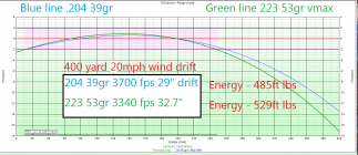

I did a ballistics graph of the 204 39gr vs 223 53gr vmax. They are closer than expected. If you say the 204 is good to 400 yards the 223 might be good to 370 or so. The 223 even hits harder at 400 yards.

Almost 3 feet of drift going to have to print out some charts for the shooters. Or do you guys just look at the dust from the bullets and make on the fly "feel" type adjustments. The 40gr Vmax have 46" of wind drift. Drop wise they are about the same as the 53s if shot at 3700.
