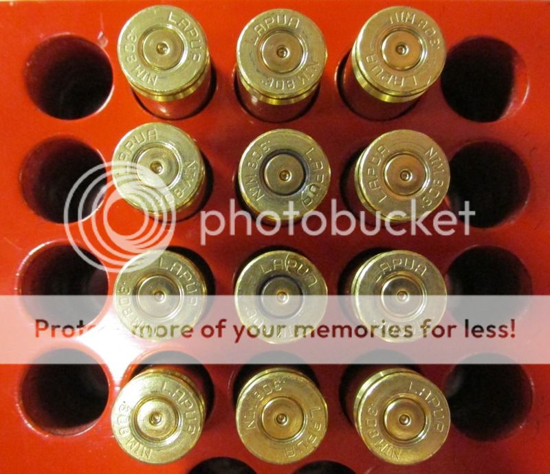

After shooting 184 rounds of 308 Win consisting of 2X Fired Lapua brass with 185gr Juggernauts, 44.40 gr Varget and KVB-7's in a match, I found two cases that had a black ring around the primer. At first, this black ring was all I saw, and suspected over sized primer pockets. But after taking the picture, below, the ejector marks became obvious, which would indicate an over pressure condition.
In the picture, the two spent cases in questions are in the middle, surrounded by 10 other cases that looks just like the all the other spent cases; i.e., no black ring and no ejector mark.
What could have caused this over pressure?
Powder Charge: I trickle every charge using an FX-120i scale, and while the great majority register 44.40 when I fill the case, I occasionally use a 44.42 gr charge instead of removing one kernel, or starting from scratch. Even if the charge were as high as 44.40 gr, I doubt if it would be enough to cause the signs of over pressure.
Heat: Yes, it was hot, and the barrel was sizzling. However, although I do drop the rounds in the chamber as soon as I eject the spent cases, I make a point of not closing the bolt until I am ready to shoot; I may shoot two to three seconds after I close the bolt. There were occasions when I had to stop to readjust the bipod, or in many more cases, to wipe the sweat off my eyes. But when I did this, I opened the bolt. Perhaps I should have removed the rounds from the chamber in these circumstances?
What is your opinion?
Thanks!
Alex
Any chance the bullets for those two were seated deeper than the others?
On ejecting the round, I do that if I do not break the shot within the normal timeframe. I put it back in the box and come back to it later. Not sure if it makes a difference or not.
The brass looks like "Regular" as in "Non-Palma" Lapua brass. The charge is at or near the top of the charge ladder and ALL of your loads, escaped gas rings or not, are on the ragged edge of pressure. If that is your load and it shoots very well, consider moving to the "Palma" S/R primer brass. You will still be on the upper edge, however, the Palma brass can MOST LIKELY handle the pressures you are generating.
I also use 44.3 grains of Varget with the Juggs and Tula LRP in my AT and it has shot well without much fanfare. Your black ring could be a primer defect (I have seen a few of these with Wolf SRM) and I would also have you check your bolt face as it probably got etched.
Have you made sure that all the lube is off your case? Any chance that one or more of your rounds got wet in a rain storm. Both of the above can cause pressure problems as they affect the ability of the case to grip the wall of the chamber and allow more push towards the bolt face.

Its clear the two cases have impacted the bolt with more pressure.
If the powder charge was the same .
3 things I would look at.
1 case capacity
2 excessive shoulder set back
3 if your not jumping.020 excessive initial ignition start pressure From the powder your using. Larry
By chance have the neck walls got thicker on these 2. I have seen where i could just slip a bullet in all fired cases and have had a few cases that would not slip a bullet in and confirmed with a mic on neck thickness and showed pressure increase like these and flyers?
Could be that they sat in the chamber too long (did they go into the group)
Could be that CBTO is a lot closer to the lands than thought and these two actually ended up into the lands. Going into the lands will cause a significant pressure spike which appears to be the case as there are strong ejector marks and leaky primers. i.e. with LRP loads at the top end of pressure, will start to leak after three firings but not necessarily show ejector marks. The presence of two pressure indicators together is a sign of significant pressure.
I believe those are bad primers.............. I contacted Winchester about some I had..... they jacked me around for so long I gave up..... don`t shoot anymore or you`ll cut your bolt face.......
bill
Alex,
I have seen this happen before. For me those cases have been involved in load development and previously exposed to higher pressures. The ejector marks could have been there previously. When they are clean and shiny our older eyes don't always catch em. Since the primers do not show any flattening and look like all others, my opinion is not necessarily pressure, from that particular shot, but loose primer pocket. There again, one would normally notice looseness when seating. Extracting primer will most likely indicate a problem. Also you might measure your extraction ring and compare to other good brass to look for expansion, which causes loose pockets.
Steve Finnell
your chamber is oversize at the .200 line,,,it is letting the case heads swell and causing loose primer pokets,,,Roger
We all assume every piece of brass out of a box is the same but are they? Weight is the only thing we can check. Why couldn't there be variations in hardness? From what you've told us I think the only explanation is you've exceeded the yield point of those two cases.

Your load is not excessive - it is Hodgdon book max (which is conservative).
None of the primers (in any of the cases, including the two in question) show the slightest signs of pressure - in fact the primers show a conservative, mild load. So it is easy to rule out excessive pressure or an over load, or a "spike" (cartridge pressures can rise, but they cannot "Spike")
If the two rounds in question had their bullets jammed into the rifling (and the others did not) then you would see pressure signs on those two primers, which you cannot see.
Since the cases were fired 2 times prior, that leaves only two possibilities.
1 - The two cases in question had soft heads - it is possible. I have had case head failures on new factory loads, where the head expanded so much that the primer dropped out and fell into the action (which is why military cases have crimped-in primers).
2 - An earlier load was excessive and the damage happened before you loaded the cases for this time, and you didn't catch it.
Also, Rockwell hardness of brass does vary over the lot. The load is on the ragged edge. Lots of good answers here.

Rodger - Most chambers are over size at the 0.200 line - if this were the cause, almost all fired cases would be ruined on the first firing - and it does not explain the ejector mark.
A few answers to your very welcomed comments -
• The cases have never been used in any other rifle. I bought them new, F/L resized them when new, and after every shooting (of course), and had been fired only twice.
• It is possible that the 'damage' may have happened earlier, as when I was testing various seating depths.
• Last night I checked the seating depths of the 16 rounds I have left over, and they were 2.313 ± 0.001.
• When I process these cases, I will measure everything and report back.
• Also, even though no one specifically mentioned it other than when 'brass hardness' was brought up, I have not annealed any of the cases.
