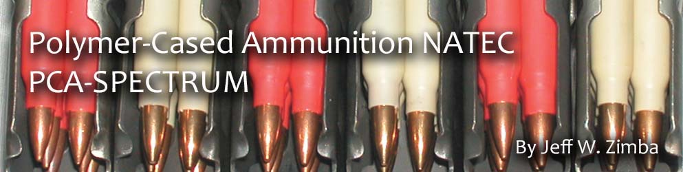

just in case you’re interested
It would be hard to confuse these PCA stamped cases.
