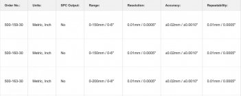

I'll add for one of the best:
Caliper Accuracy
Mitutoyo ABSOLUTE Digimatic
Note the accuracy of the caliper itself is limited to ±0.0010 and there will be additional error due to the fit and cleanliness of the attachments and due to the users technique. My son has been in the metrology business over 20 years including calibration of calipers and micrometers for many customers. He also trains customers employees in the use of measurement instruments. His considered opinion is that a regular practiced user might achieve ±0.001 resolution and ±0.002 accuracy while an occasional user might achieve ±0.002 resolution and ±0.003 accuracy for a caliper that is regularly serviced and calibrated (annually by current ISO standards).
You all should feel free to discuss the impact of the above data and comments.

“Note the accuracy of the caliper itself is limited to ±0.0010”. I disagree with this depending how the wording is interpreted. The accuracy is never worse than +\- .001. The actual accuracy of the instrument may be much better. In my personal experience it *is* much better.
In industry we control quality using worst-case specifications. If I was producing actions or machined parts for shooting I would need handle my production that way. But in shooting and reloading we deal with actual performance.
Most reloaders use calipers with comparators. Repeatability is the more relevant spec for this. Good calipers like these are repeatable to within .0005” which is plenty of resolution to control the processes at hand. I’m talking measurement of a easy measured feature like a gauge pin or block.
Environmental conditions matter. Cold stiff hands, hot tools and components, different operators, and temperature differentials do skew numbers. My context is me, using my tools, in my uninsulated garage.
Now, are comparators attached to calipers repeatable to that tolerance? - no, not in my experience. It’s hard to get traditional comparators to within +/- .001”, which is right in line with my seating dies performance. The seated bullet is never as uniform as the gauge standards. To improve that variable further, if I so cared, I might lap my comparator to better conform to the bullets contour. But I haven’t done that because I don’t feel it’s necessary and because the better next step IMO is to make my comparator measurement point closer to where it contacts the lands. And that would trade making the comparator less repeatable but its measurement more relevant.
And for what it’s worth I do have some gauge pins and blocks. So I’m not making any of these assertions on speculation. I keep tabs on my personal instrument accuracy without wasting the money for formal calibrations. So far so good no surprises.
