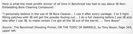

If you want a rifle clean then you need to use a paste. I find I can get it close with foam but about every third cleaning there is too much felt behind and JB leaves nothing behind. I was told by a friend to clean my 6.5 till it was perfect, and bring it with me when i came to shoot on the weekend. When I got there he produced a hawkeye borescope and showed me all kinds of carbon left in the corners of the rifleing. i put a patch on a Parker -Hale jag and gave it 25 strokes with JB on the patch then a second look on the hawkeye and no more carbon. If you haven't looked through a bore scope at a before and after on a barrel, you have no idea cause you don't know if it is clean or not and cleaning till you get a clean patch is a joke, it means nothing.

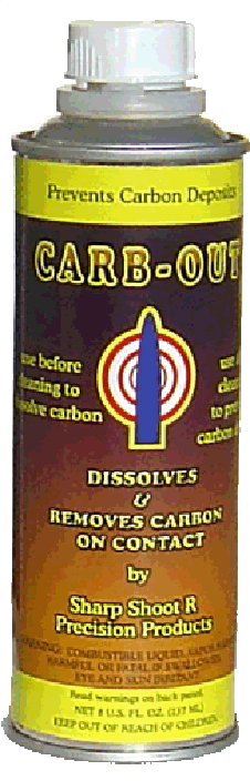

Hard carbon needs removed by mechanical means. Either brushes or abrasives. Solvents aren't going to do much. What shooters think is carbon coming out is loose powder fouling. It'll wipe off with anything.
