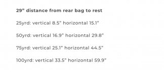

What is the range of movement for joystick - will it cover a short range score target top to bottom?
Tim, keep in mind that I've only been to the range twice with it and most of the time was getting used to setting the rest up, getting used to the adjusting system, etc. The joystick itself moves 5" from center to both the left and right. On the range, that movement is, literally, about two target positions wide. I personally have not used a rest with the amount of movement the Trident has. And the feel and touch of the rest glides so smoothly it is amazing. Our weather has not been conducive to bench shooting, but as soon as I can I will go again and try to get some better info.

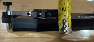

Trident is a rest that I designed with portability in mind. The base can be disassembled for travel mode like in the picture below by unscrewing the stainless bolt that connect the two base together.
I have watched the video dozens of times and in my humble opinion, the stainless bolt that hold the two base together wasn't tightened enough or became loose due to vibrations. This causes the front part where the body rests to be able to shift due to recoil. I too still have much to learn and in this case I think there needs to be a way to prevent this from ever happening even unintentionally.
The two base parts use a wedge shape to self lock so having the bolt tight enough is key in having the two parts become a single solid part. I will add a Nord lock vibration proof washer to ensure that the two remain securely locked together throughout your shooting session.
But, there's a catch. The current stainless bolt is too short for this improvement and I will need to remake them. I'm still new to this industry, and I truly want to give the best I can. As this is a crucial feature to the rest, I will have to postpone all shipments for Trident and fix this issue first before I ship out any more Trident. I much rather ship a good product late than ship a flawed product that you wouldn't enjoy using.
To sweeten the deal, based on the input I received not just from F-class John but also other shooters, I will add adjustable lever to the side plates and also an improved version of the forend stopper. For those who have already received their Trident, I will ship out replacement bolts plus adjustable lever and stopper free of charge.
