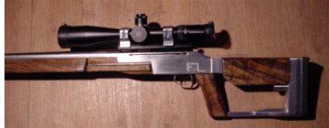

My new F-class rifle in 7MM SAUM
stock en rings home made from Alu Turkisch walnot en bolts are titanium
action Barnard Barrel true-flite scope Schmidt@Bender

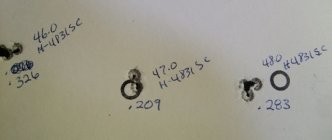

My BFP (big friggen pistol)
First off I've always wanted a long range pistol built on a XP 100 action. About three years ago I purchased a XP100 blueprinted action complete with a PT&G PPC coned bolt from another 6mmBR forum member "Melvin". Not being sure where to get a specialty stock made I just put the action in the safe. Every once in a while I'd see a picture on this forum of a great looking XP stock by forum member "Preacher". So I decided to contact him to find out if he possibly new of anyone that I might commission to build me a stock. I really wanted something different, I wanted a stock with a long 3" wide forearm to support a over 20" full bull barrel and enable better bag tracking. Instead of using the regular clear coat finish I wanted to use a product called Arrow Wood Finish. Preacher apparently took pity on this old man's desire to own something a little different and offered to build the stock for me. The amazing thing is he doesn't use a duplicator, his stock are hand carved and crafted.
Here's my new 25-284 Win wildcat switch barrel XP 100 long range bench pistol. She's a big girl with scope weighing in at 14.2 lbs and a long drink of water at 32&1/2" oal, best of all she'll flat out shoots. Can you believe these three shot groups shot by "Preacher" while doing load development. What's remarkable is that this barrel isn't even broke in yet he achieved these results after shooting only nine shots and cleaning after each shot and then shooting three 3-shot groups with the hunting bullet of my choice, a 115gr NBT. I'm using the 25-284 barrel out high stands on our lease for deer hunting and feral hog control.
It's a switch barrel but I haven't yet install the the second barrel which is chambered in 22BR. I plan on putting it to good use this summer in the prairie dog towns. I'm already familiar with loading for the 22BR and it should be as simple as just fine tuning one of my already proven loads in time for the shooting season. So I'll have to wait a while to comment on that barrel.
While Preacher was busy making my stock my action was at another smith, Mark Pharr of Tumbleweed Custom Rifles located down here in Texas. I had Mark open the coned PPC bolt face to .473, install a rocker style bolt release, pin a .250 tapered PT&G lug, install a Jewell and set it at 6oz, bush the firing pin hole and turn the Callahand speed lock assembly firing pin to fit and chamber a barrel in 22BR with zero free bore to shoot the 40gr Vmax.
I can't begin to say how enjoyable this build became after I finally got the action delivered to Preacher, he preferred to have my action for the pillar/glass bedding work even though he had a XP action that he could have used to do the bedding work. He wanting to be sure that the results of all his hard work provided as stress free as possible bedding job on my action, the man is a perfectionist. Sometime during the stock build Preacher and got to talking about his pet wildcat cartridge the 25-284 Win and I wisely ask him if it would chamber me a new barrel for that cartridge. He agreed to do the addition work and suggested that he use a straight 1.250 contour Brux barrel which we decided to finished at 22" and install one of Harrell's muzzle brake. Preacher really provided service way above and beyond what one would ever expect for any smith, helping to make this project fun and doing everything within his power to insure that it turned out to be everything I hope it might be. Without his help and dedication to quality this project would have never taken shape. I truly owe him a debt of gratitude. This build has most definitely exceed my expectations and it's been sometime since I've been able to say that.
I'm hoping that this unique heavy XP pistol might get consideration for placement in "Guns Of The Week".

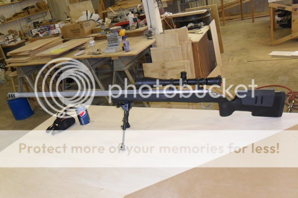

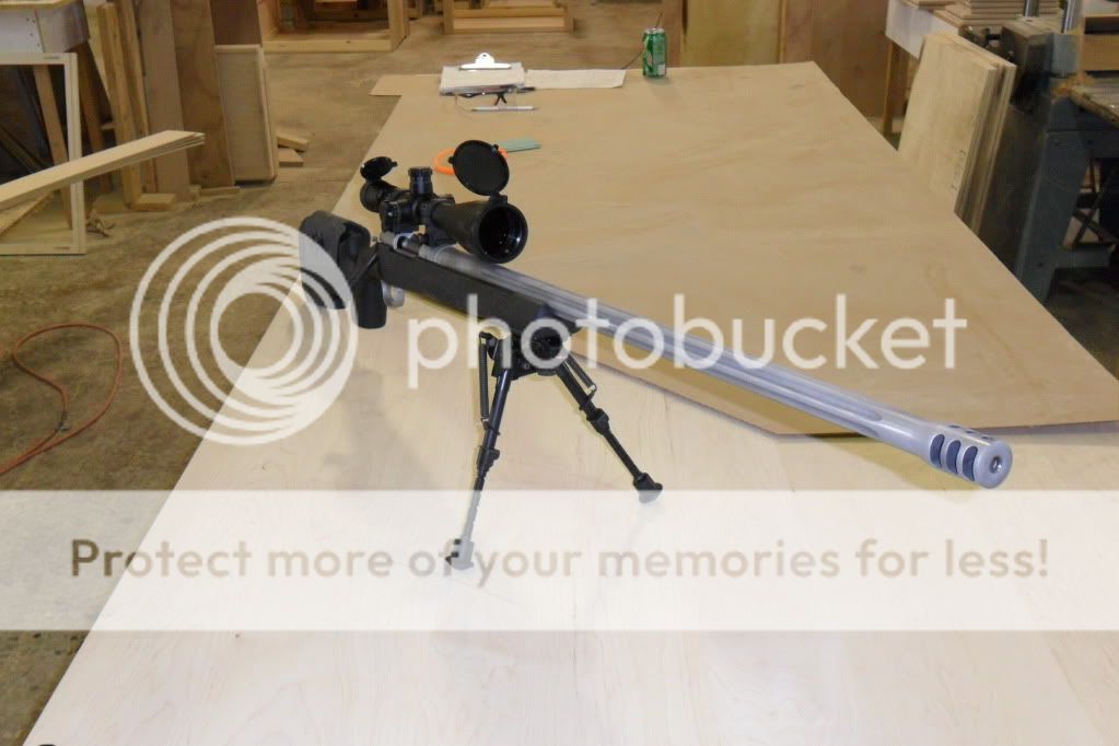

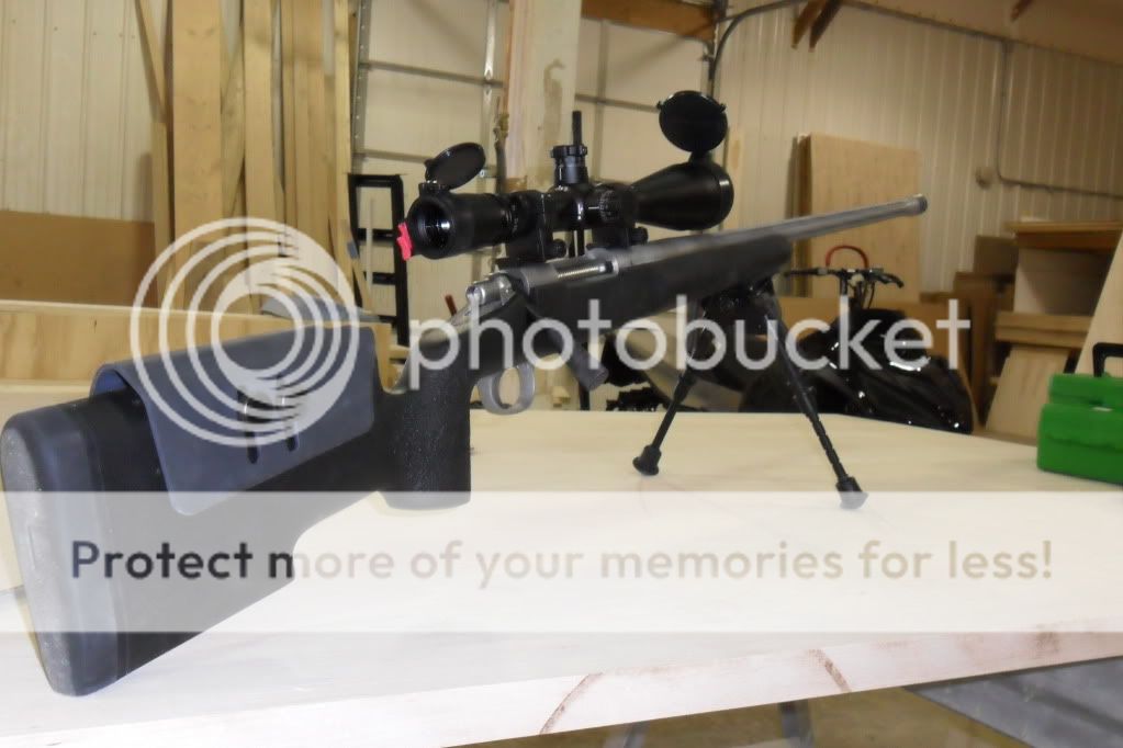

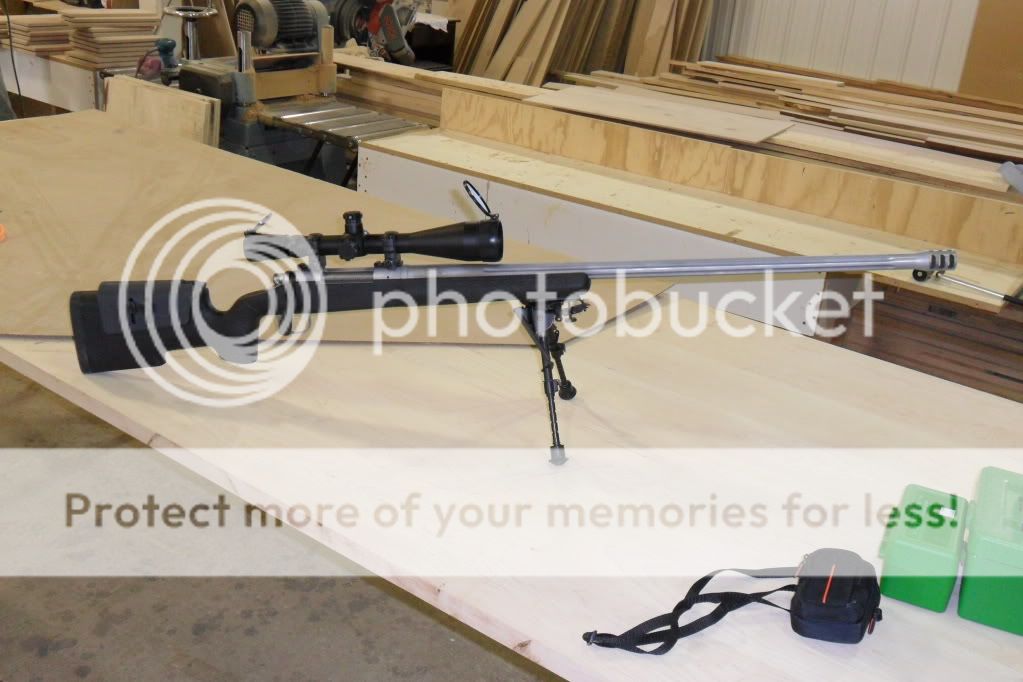

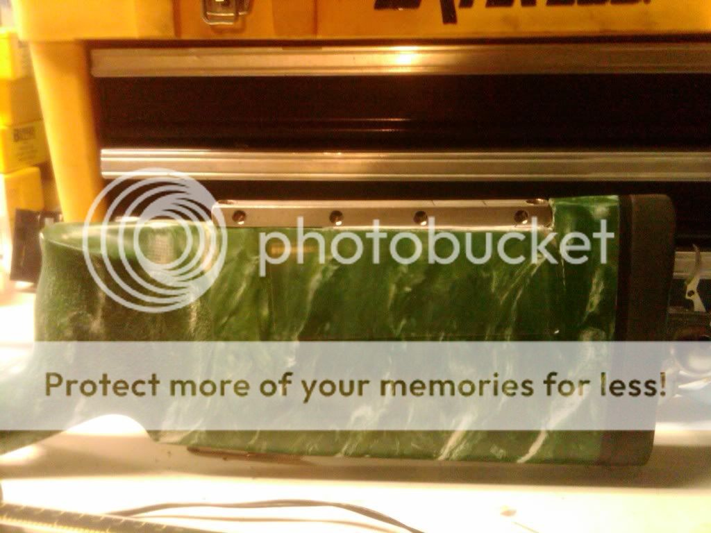

Finally completed my new 300 WSM build for ground hog/varmint shoots and 300/600 yard league.
Savage Target action with PT&G oversize bolt body, sss true/time and evo trigger.
30’’ Brux 10 twist 1.250’’ barrel with Harrell’s break hung in a 5.5’’ aluminum barrel block.
McMillan MBR Tooley stock with the butt reworked with a 5/8 flat that is also drilled and threaded for a removable 2.250’’ darling guide. I milled the stock parallel with the forearm and screwed a piece of stainless to it and used fiberglass to shape it.
Sightron 10-50x60 scope in Burris signature zee rings on Ken Farrel base.
Weight is 22+ pounds
Only have 60 rounds through it with 208 amax bullets, but it looks like it is going to shoot very well.
I shot it before it was painted and the first 5 shot group at 125 yards was under .5’’ and this was shots 6-10 on the barrel after sight in. Load was H4350, 208 amax .020 jump, F210m primer. Starting to do some load devopement now.
