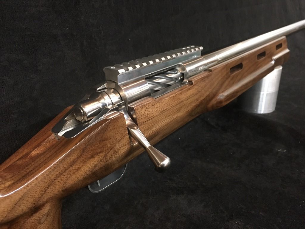

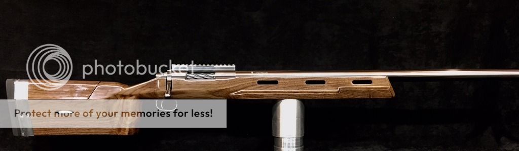

New F-open build:
6.5 x55 Bob Jourdan Ackley Improved
Borden BRM-XD action/20 MOA Pic. rail
Flavio Fare' trigger @ 2oz.
Bartlein 5R 30" 1.25" straight tube chambered with JGS reamer
X-Ring Rifle Stocks Robertson pattern in walnut
Riflesmith- Shawn Broussard, Titan Precision
