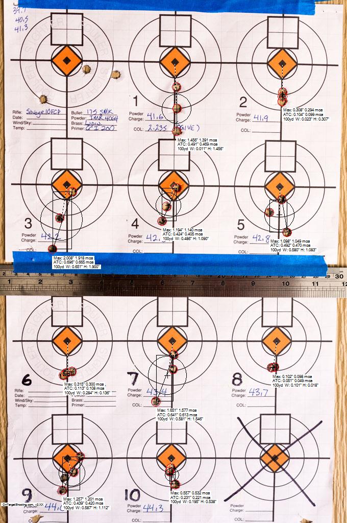

Yesterday I shot an OCW series (Optimal Charge Weight, see: http://optimalchargeweight.embarqspace.com/) from my Savage 10FCP HS Precision using the following components:
Bullet: Sierra 175gr BTHP MatchKing (SMK)
Brass: Lapua, new, full length sized
Powder: IMR 4064
Primers: CCI 200
COAL: 2.235 (at the ogive, with comparator)
I loaded sighters at 39.7, 40.5, and 41.3 grains. I had previously tested and found 44.3 grains to be max for my rifle before adverse pressure signs started showing up, so I used that as max in this test.
I shot these loads at these numbered targets:
Target Grains
#1: 41.6
#2: 41.9
#3: 42.2
#4: 42.5
#5: 42.8
#6: 43.1
#7: 43.4
#8: 43.7
#9: 44.0
#10: 44.3
Observations.... extremely tight groups at #2 and #6 but I realize that is not what OCW is all about. Nonetheless, nice groups.
Note that #8 only has two holes, and the group sizes for those two is only .103" according to the OnTarget software. Problem is, when shooting the third rotation of the round robin I mistakenly shot #3 of the target 8 group into target #9. I did see which one it is, (it is the second from the bottom), which if that had been shot at #8 would have made for another tiny group.
So, what kind of analysis can we make from this? I think there may be a node in the #4 to #5 range. Not sure, this seems a difficult one to analyze.
Here's the target:
you need to go to longer range (300 or more), look for small verticle in the groups. I would shoot #6 and #8, then try changing the seating depth.
Thanks. This is an Optimal Charge Weight series, not an Audette ladder test. OCW stuff is generally shot in round robin fashion at 100 yards.
If this were my group, this would be my thought process:
* looks like I might have 2 nodes, one around 42.5-43 grains. It also looks like I have one around 43.8-44 gr. Being that 44.3 gr is my max charge and that I am using IMR4064 and with it being known to be a little temp sensitive, I would work around 42.5-43 grain range.
* I would tighten the charges and extend slightly beyond my range to determine if it is a true node, so I would load 3-5 rounds of 42.3, 42.5, 42.7, 42.9, 43.1, and maybe 43.3. I would shoot this and see if the shot pattern is consistent. If it is, I go to seating depth.
* Once I determined that it is a true node, I would then either try to shoot this at 300+ yards to validate or I would take the middle charge of the range (so I would choose maybe 43gr and then start creating rounds with seating depths in 0.010" increments to finalize my load.
as a point of reference (and ONLY a point of reference), my friend is using 42.5gr 4064 and 175gr SMK in his 19" bolt action.
If it were me.
Shoot some groups, if that vertical doesn't disappear increase comparator length to 2.240" and try again.
Even though it's only 100 yds I see some great potential from that gun once it's dialed in. Enjoy.

This rifle seems to have the potential for good accuracy. However, the variance in vertical spread from one group to the next suggests that something is wrong with the gun mechanically or with the shooting set-up.
If everything is set up right, and the barrel is not moving in the action, I would expect that something in the .75" range (for 3 shots) would be your worst result, no matter what the load.
When I see something like #7 (1.651"), I am thinking mechanical problem, scope issue, funky rest or something else. We've seen Savages that produced erratic groups like this because the tenon threads were oversize and off-axis.
The groups #6 and #8 are impressive -- I would certainly keep testing in that range, or just do repeated groups at 43.7, your #8 load.
However, your target is telling you that something is wrong that has nothing to do with powder.

With 4064 i found somewhere around 42.5gr is the best nodes and with a jump of .015. I would differently check torques on scope and action screws make sure they are even. Do the test over and make sure the natural aim is the same there is too much vertical in the shots to say its the powder charge.
