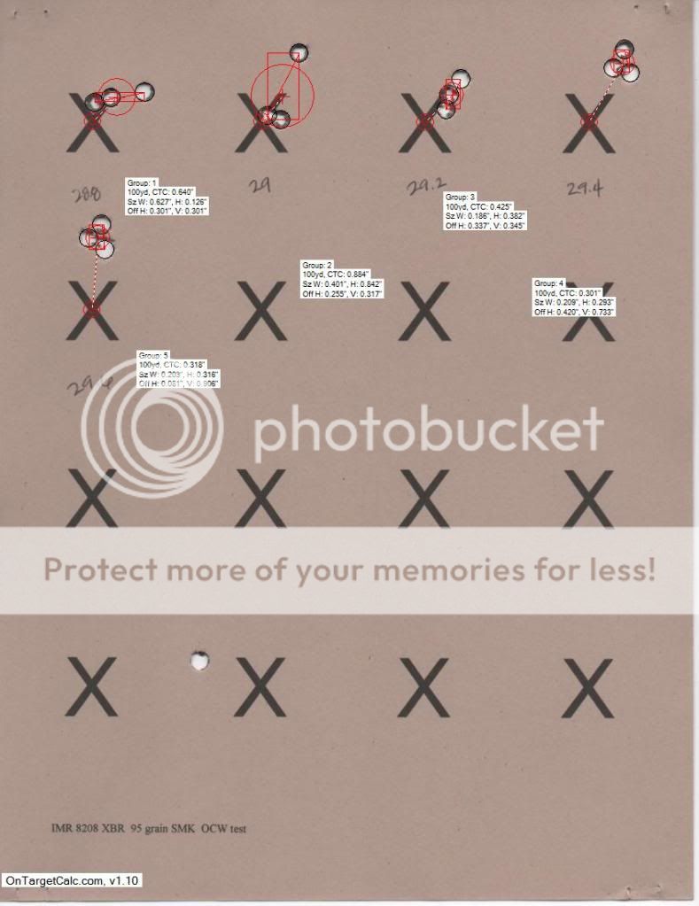

Here is an OCW I shot using 95SMK's in my 6br. I just used word processor to make X's at an appropriate size and font. This target is very easy to hold dead on and exactly the same spot at 100yards.
The obvious scatter node is at 29 grains, this puts my OCW right around 29.5.
In went with that and messed with seat depth, and settled on 29.4 to keep pressures in the workable zone for many rounds with out cleaning and temps that start low and rise throughout the day when I shoot.
This load is very good and repeatable in my rifle.
