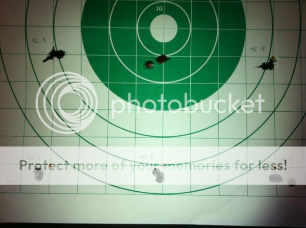

OCW results, opinions please
Savage 12 FTR .308, Lapua brass, varget, fed primers, .018 off the lands. All rounds were shot round robin @ 100 yards. This is the first time I tried this method. What am I looking for?
according to your orange dots, 42.6 would be your OCW. If you didn't see pressure signs at 43.8 keep working up until you find next node. It looks like You should be able to find 3 nodes--a high, low, and middle node.
You want to aim at the same aiming point, fire your groups. Look for the 3 groups together with same POI and then you chose the middle charge. From there you can do seating depth test to see what shrinks your groups. Did you shoot the groups "round robin"?
What bullet are you using? I think you could keep going higher in charges since I do not see a scatter group at all over those 6 charges.
http://optimalchargeweight.embarqspace.com/
You've got one node in between 43.2 and 43.5. You should get another node around 45. That's looks like a good shotting gun.
I actually had 9 loads for the test and all were shot round robin ( the lower charges averaged 1 moa). I would shoot loads 1-9 then let the barrel cool and proceed with the next round of loads.... etc...
I'm using the 175 SMK.

I think you need to be shooting at a much longer distance to really get good results, especially with the 308. I think a minimum of 300 yards, preferably farther. Maybe load up the same charges you used for this round and shoot in the same order but at longer range and see if the results are the same.
the OCW is meant to be shot at 100 first. Then you can load them and shoot at distance to confirm/tweak the load if need be.
The high node should be 44.5-45.0 grains from what I have seen/read. Your gun may be different. Unless you are satisfied with that velocity I would step them up in charge to mid 44 and see what you get.

I'll probably look for a high node the next time out and then I will pick from there and start chronographing the loads. I'm looking for a 1000 yard round. Over all, I'm pretty pleased with how the rifle shot for its first time out.
Rob
I've not shot that bullet but I think the 44.5-45 will get you happy and out to 1000 with good results.

I think the OP would be better served by moving out farther based upon the target he posted. That is my opinion. And by the way, if you were following the OCW method the optimal charge would be around 43.2 gr. not 42.6 for that target.

OP looks like your gun is a shooter. You should do well with finding your load at a higher node. If you read the other forum you will see most loads found using OCW will shoot at distance
What "you think" has nothing to do with the methodical approach taken by Newberry in developing OCW. You probably view reloading manuals as just interesting reading and suggestions rather than scientific data produced by real tests.
One should follow his instructions. BTW, if you do follow them you will see that after OCW is done at 100 and optimal bullet seating depth is found Newberry recommends shooting this load at your maximum range.
Also, the OP has this same thread posted in another forum where I suggested the OCW to be 43.2 grains.
I appreciate all the replies.... I know the 42.6 gn load hits the POA far better than the others....Just trying to follow the OCW method to the T....... So far out of 27 rounds, I think I have saved a lot of time from the OCW method than the others.......
Not to complicate things.......After I find a my OCW, I will move out to 300 and do some ladder testing and do some not so scientific reasoning to come up with the load I feel will work best.
